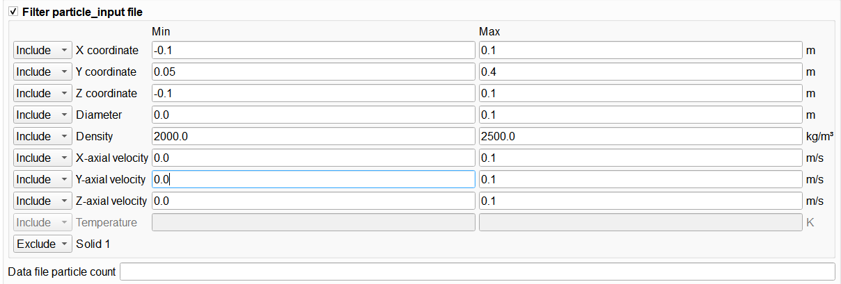

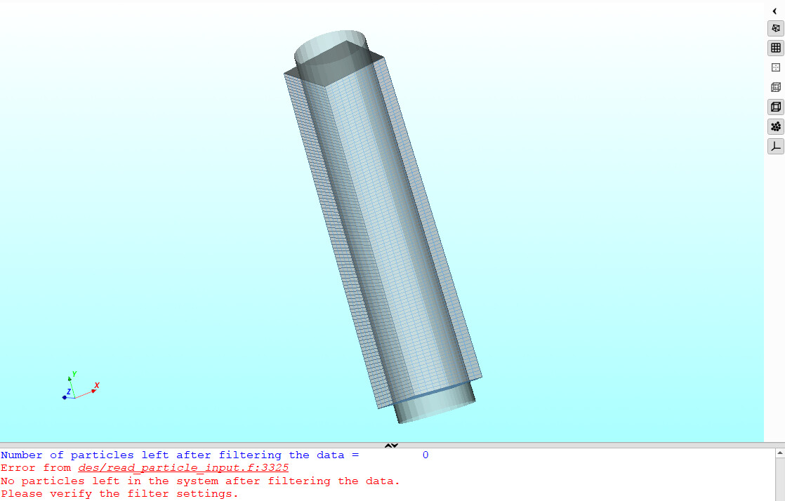

Hello, after I imported the particle_input.csv file in the editing section and set the filtering parameters, why aren’t the particles in the file displayed, and the simulation cannot proceed? I hope to get some help, thank you.

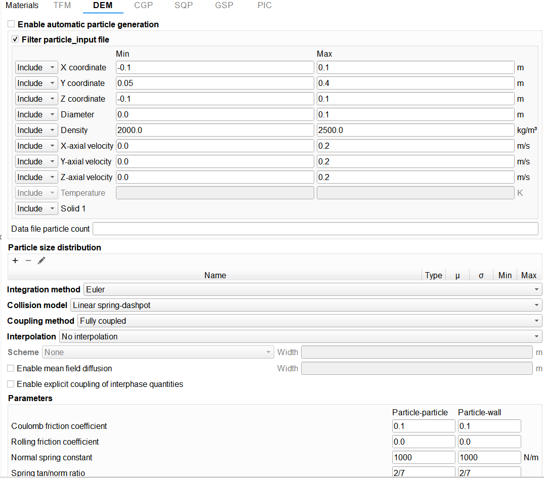

Do you have more than one solids phase? The filtering shows you exclude Solid 1.
Please attach your files if you need further assistance.

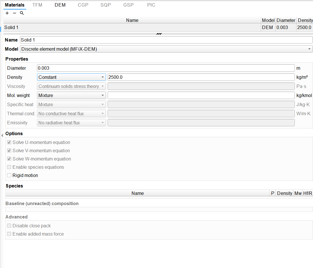

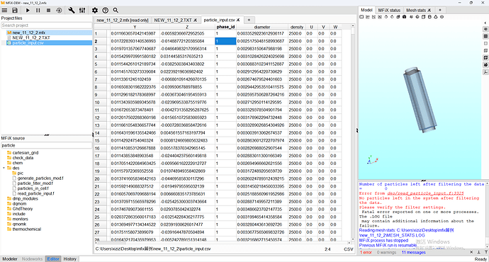

Thank you for your reply. I checked my settings, and I only have one solid phase. I modified the settings to include Solid 1.It seems like it didn’t have any effect either. Could it be that my file list uses a normal distribution, so it cannot be recognized? The two images below show the parameter settings of my Solid 1 and the file filter parameters after modification. I have also attached my zip file. I hope to get a reply, thank you.
new_11_12_2.zip (575.6 KB)
