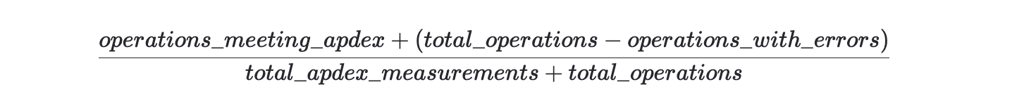

The budget is calculated based on indicators per component. Each component can have two indicators:
  • Apdex: the rate of operations that performed adequately.
    The threshold for "performing adequately" is stored in our metrics catalog and depends on the service in question. For the Puma (Rails) component of the API, Git, and Web services, that threshold is 5 seconds when not opted in to the rails_request SLI.
    We've made this target configurable in this project. To customize the request Apdex, see Rails request SLIs. This new Apdex measurement is not part of the error budget until you opt in.
    For Sidekiq job execution, the threshold depends on the job urgency. It is currently 10 seconds for high-urgency jobs and 5 minutes for other jobs.
    Some stage groups might have more services. The thresholds for them are also in the metrics catalog.
  • Error rate: The rate of operations that had errors.
The calculation of the ratio happens as follows:
\frac {operations\_meeting\_apdex + (total\_operations - operations\_with\_errors)} {total\_apdex\_measurements + total\_operations}

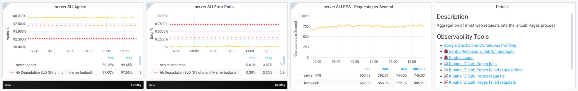

Other components visible in the table come from service-level indicators (SLIs) defined in the metrics catalog.
For those types of failures, you can follow the link to the service dashboard linked from the type column. The service dashboard contains a row specifically for the SLI that is causing the budget spent, with links to logs and a description of what the component means.
For example, see the server component of the web-pages service:
web-pages-server-component SLI
