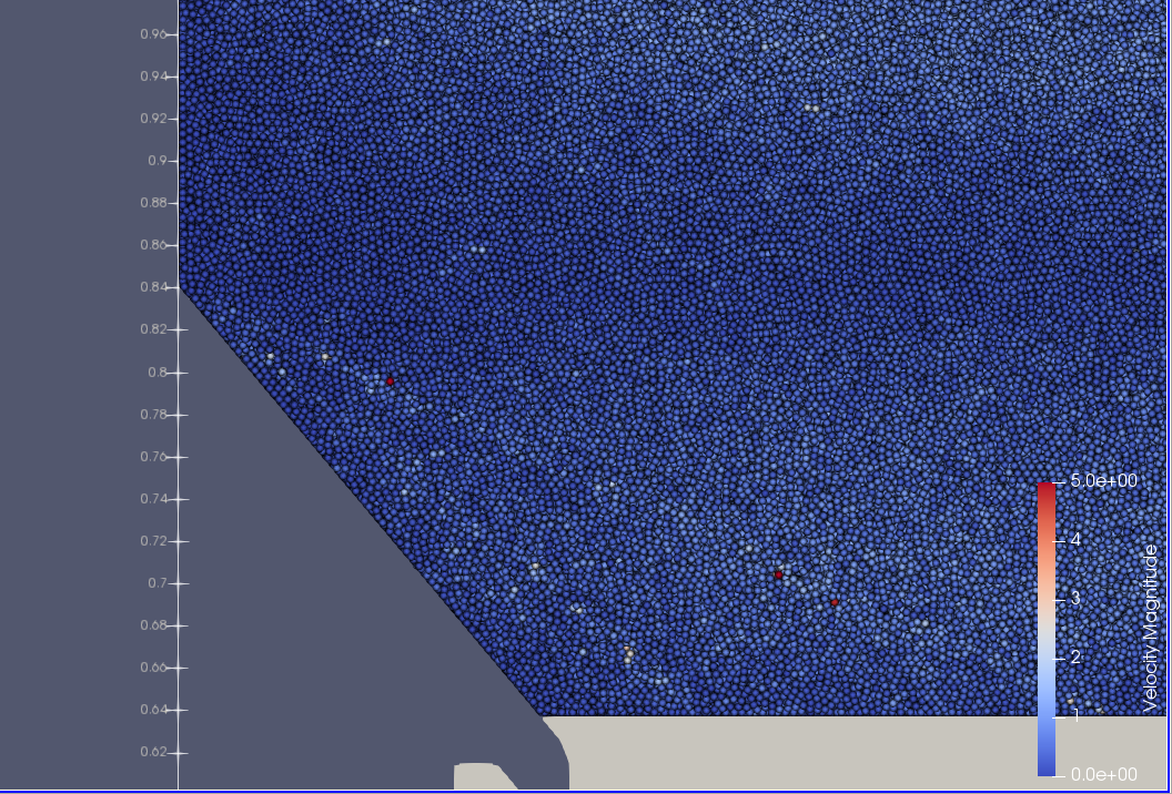

I am trying to model a 3D spouting bed with a complex internal geometry. To simplify the case and get the simulation and mesh parameters honed in I removed the internal geometry and settled the bed. For the base case I got particles to settle by incrementally moving an internal non-permeable boundary down. The DEM velocities were all reasonable, as seen below:
The final geometry is the base case with an additional section connected to the bottom of the domain to form an internal geometry. When the IS placed above the cone (Y=0.84). The settling particles velocity is reasonable.
When the IS is moved down (Y=0.64) the velocities increase gradually as would expected for particles in free fall. But then it jumps an order of magnitude (0.3m/s to 91m/s). These particles is in the middle of the domain. I keep getting particles in ghost cells errors as these high speed ones go straight through my walls.

Did you change any of the mesher options? Specifically, have you messed with the default stl_small_angle? I’ve seen a DEM case in the past where a user set that keyword to zero (to avoid losing facets), but that can let malformed facets with a zero angle through. The case ran fine until a particle touched one of those facets, at which point the particles would go nuts.

I re-meshed and used a STL with coarser triangles. With stl_small_angle = 0.1 the particles still behave with irregular high velocities. It seems the happen when the particles move over the internal surface.
