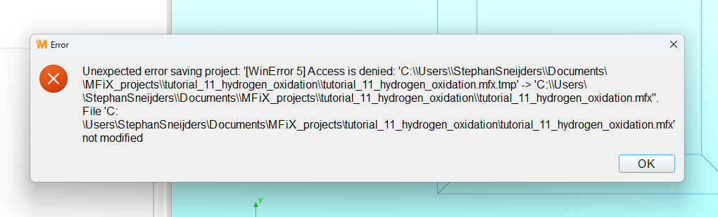

The issue might be related to another issue that I’m facing quite often in some cases. In some cases I get an error message that the file couldn’t be saved. Then if I just try again, it does save the file. Especially in this tutorial it happens every time I try. I have attached another print screen:

A few other users have reported this [WinError 5] Access is denied but I’ve never been able to reproduce it myself. After doing some research, I think it may be due to antivirus software. We write to a temporary file and then move that to the destination. If the temporary file is being scanned (as all newly written files are), this Access error will occur. I’ve never seen this because I have antivirus scanning disabled on my Windows laptop (don’t tell anyone!) because I’ve found it uses a lot of CPU and slows things down.
If this is the culprit, then an easy fix is to add a little delay/retry before the file move operation. If you’d like to help us test this, download the attached file, open a Miniforge prompt, do conda activate mfix-25.2.1; then navigate to %CONDA_PREFIX%\Lib\site-packages\mfixgui and replace the file gui.py with the file attached below. If this clears up the issue, I’ll add this fix to the next MFiX release (25.3, due out in a few weeks).
Thanks!
gui.py (154.1 KB)

I have replaced the gui.py file and didn’t encounter the [WinError 5] Access is denied error anymore. The issue seems to be solved with this patch. In case the error unexpectedly shows up again, I will let you know.

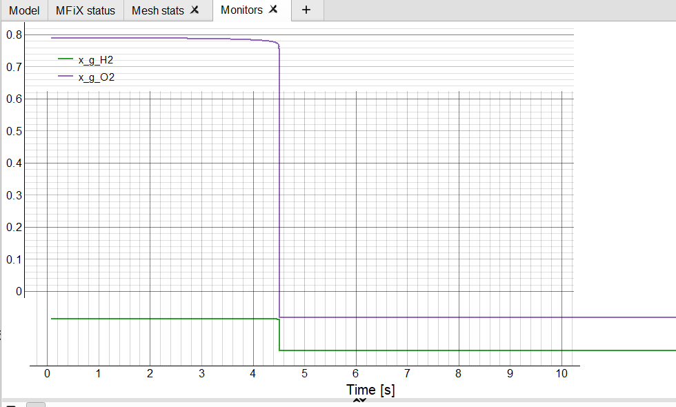

When viewing the monitor results of the simulation, I actually found out that there is a difference between my results and the screenshots in 3.11. Hydrogen oxidation in a batch reactor using CHEMKIN mechanism — MFiX 25.2 documentation, e.g. in my case H2 and O2 concentrations went negative while in the tutorial screenshots they didn’t. I have noticed that this issue of wrong axis alignment also happens in other tutorials so it is not tutorial specific. Please let me know if you want me to post this in a separate thread.
It’s a good idea to create a new issue once a topic has been marked “solved”. Otherwise it probably will not get any attention.
