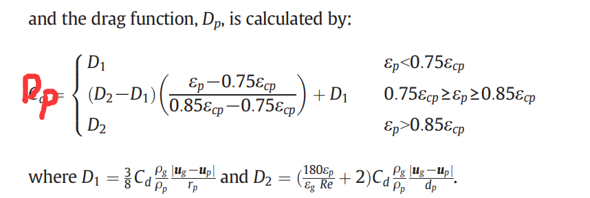

For the WEN-YU drag model, It seems the expression of drag coefficient coded in MFIX is different from that posted in the theory document, as shown below.
The multiplication by the solids fraction (EP_SM) is done outside this subroutine, where we also differentiate models A and B.
Thank you for your information, Dr. Dietiker. But, there is still something confusing. EP_SM is not the main difference between Model A and Model B. Why it is was put outside the subroutine?
My guess is it was a arbitrary coding choice (pass the solids fraction as an argument to the subroutine or do the multiplication outside) made at the time the code was written.
