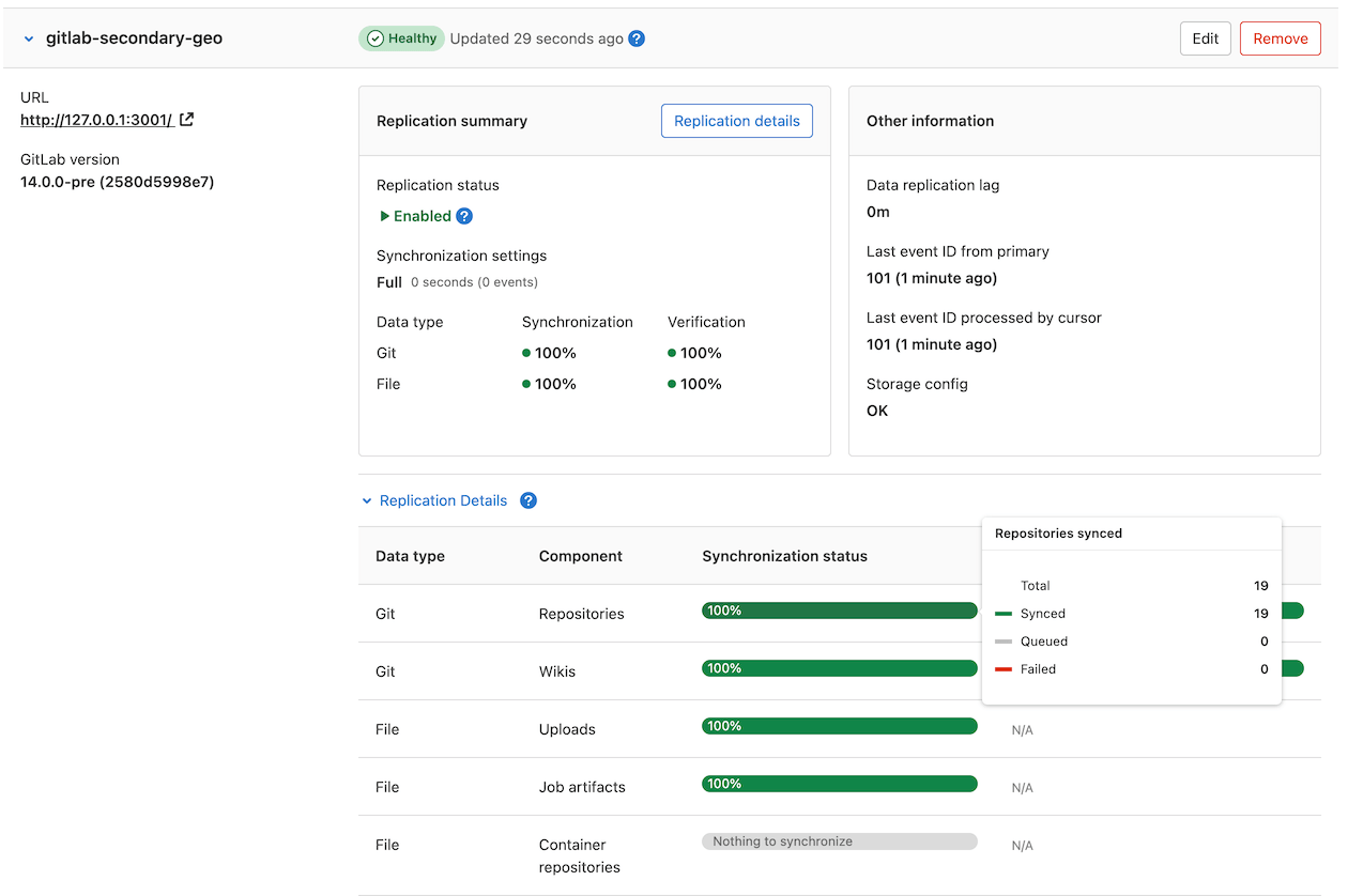

Ensure Geo replication is up-to-date
The maintenance window does not end until Geo replication and verification is completely finished. To keep the window as short as possible, you should ensure these processes are close to 100% as possible during active use.
On the secondary site:
  1. On the left sidebar, at the bottom, select Admin.
  2. Select Geo > Sites. Replicated objects (shown in green) should be close to 100%, and there should be no failures (shown in red). If a large proportion of objects aren't yet replicated (shown in gray), consider giving the site more time to complete
    Geo admin dashboard showing the synchronization status of a secondary site
If any objects are failing to replicate, this should be investigated before scheduling the maintenance window. Following a planned failover, anything that failed to replicate is lost.
A common cause of replication failures is the data being missing on the primary site - you can resolve these failures by restoring the data from backup, or removing references to the missing data.
