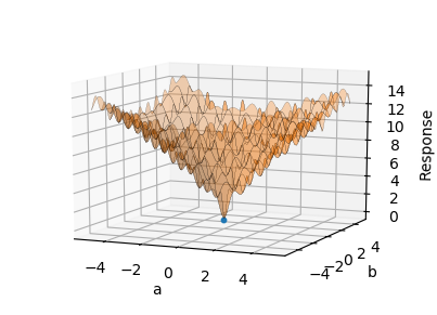

The attempts can be visualized on the Plot
tab of the General Optimizer
node, where the surface is the sampled function and the dots are the
optimization attempts. Note how these particular attempts never found the global
minimum:

After the node has run, all 10 optimization attempts should be roughly the same value, \(f(-0.02, -0.02)=0.19\). The differential evolution algorithm did a good job of avoiding the local minimas and finding the true minimum. Unfortunately, this value is not precisely the true minimum, which should be \(f(0,0)=0\). The problem is that there are not enough samples at or around the true minimum for the surrogate model, constructed in the Response Surface, to accurately represent the sharp minimum of the Ackley function.
