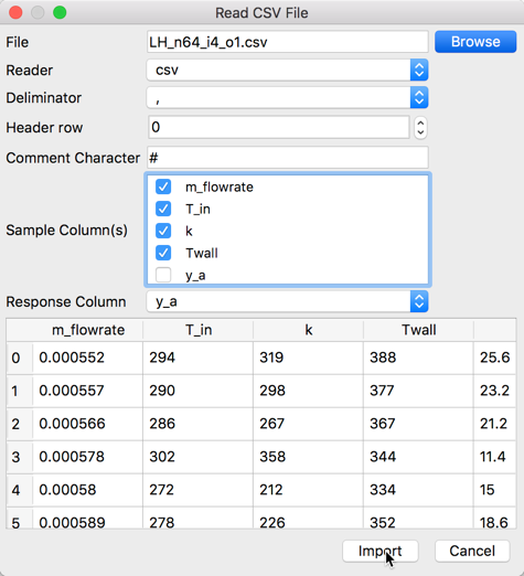

In the
Response Surfacenode click on theImportbutton in the first tab underDataThis will open a new window titledRead CSV Fileas shown below.![]()
Select the datafile in CSV format, which contains the 64 sample Latin Hypercube for four parameters (m_flowrate, T_in, k, and T_wall) and one response variable (y_a) by clicking the Browse button. Once the correct file is located, the available dataset will be previewed in the window. Unclick the last entry y_a to remove from the
Sample Columnslist which is used to designate which columns in the file will be treated as input parameters. In the entry forResponse Column, use the scroll bar on the right side to scroll down and select y_a as the response variable. To import the dataset into Nodeworks clickImportbutton after making the above changes in the window.![]()

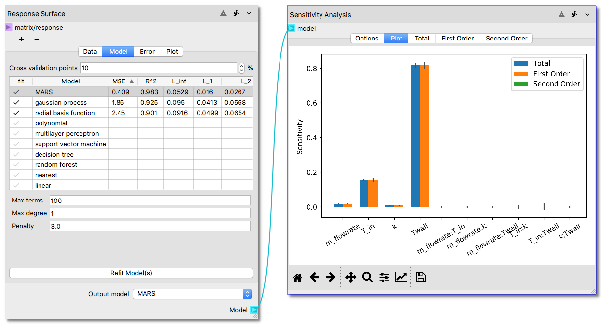

- Next step involves testing different surrogate model methods to assess the best data-fitted surrogate for the given dataset. In the
Response Surfacenode, click on theModeltab and set theCross validation pointsto 0. Next check and highlight several surrogate model options that is expected to give best fit. For this example, we will selectgaussian process,polynomial,linear,radial basis function, andMARS. Note that the wall clock time required to construct surrogate models with more options may noticeably increase as the sample size substantially increases (e.g., from 64 to 10000 samples). Each surrogate model option comes with its own set of parameters for tuning the process, which will not be changed for this example, and the defaults will be accepted. However, user is encouraged to understand these parameters and explore their effect while in pursuit of the best data-fitted surrogate model at this phase. The selection of the surrogate models before initiating the process for construction are shown below.![]()
To initiate the surrogate model construction process hit
Refit Model(s)button where the mouse cursor in the above figure is placed. After the process is completed user should see surrogate model quality metric calculated as shown below. Note that you may need to enlarge the node towards right side to be able to see the additional metrics shown in the figure. Clicking the header of any column triggers sort based on the numeric values in that column, which helps to better assess which method achieved the best fit based on the surrogate model quality metric such R 2.![]()

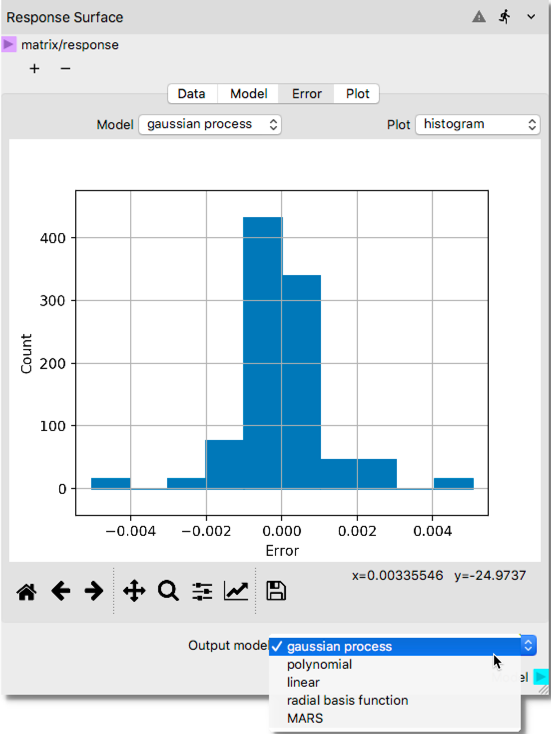

After reviewing the metrics to assess the quality of the fitted response and/or graphical visualizations showing the error for fitted response surface predictions at the actual sample locations, select the best suitable response surface in the
Output Modelfield at the right bottom using the scroll bar as shown in the below illustration.![]()
5. After constructing an adequate response surface to characterize the relationship between input and outputs, add a
Sensitivity Analysisnode from Surrogate Modeling and Analysis collection of the node library.![]()
Then, connect the
Modelterminal of the Response Surface node to themodelterminal of the Sensitivity node, as shown in the illustration below.![]()
To start the Sensitivity Analysis, click
Calculate Sensitivitiesat the bottom of theOptionstab. As shown below, it will retrieve the input parameter dataset from the Response Surface Node. The lower and upper bounds of the input parameters will be displayed in this tab after the completion of analysis.![]()

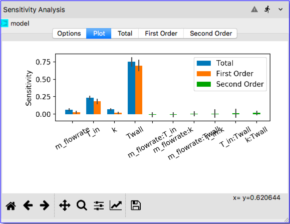

The results of the Sensitivity Analysis can be visualized in the
Plottab. As shown in the following illustration, after clicking thePlottab a bar chart is created. First order Sobols’ indices show the main effects, i.e., the effect of the each input parameter considered standalone. The second order indices show the interaction effects such as interaction of mass flow rate with inlet temperature (labeled asm_flowrate:T_inin the x-axis of the bar chart). Total indices shown with blue color is an aggregate result for the overall effect of each input parameter. The bar chart shows that among the four input parameters, the wall temperature has the most influence on the system response.![]()

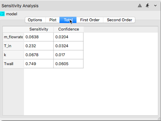

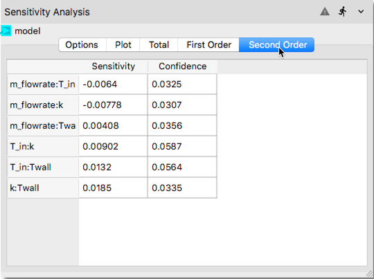

The remaining tabs in the Sensitivity Analysis node (i.e., Total, First Order and Second Order) show quantitatively the values of the sensitivity indices displayed graphically in
Plottab in a tabulated format as shown in the following figures.![]()
In the tabulated data compiled, first and second columns show the computed Sobols’ indices and confidence interval, respectively.
