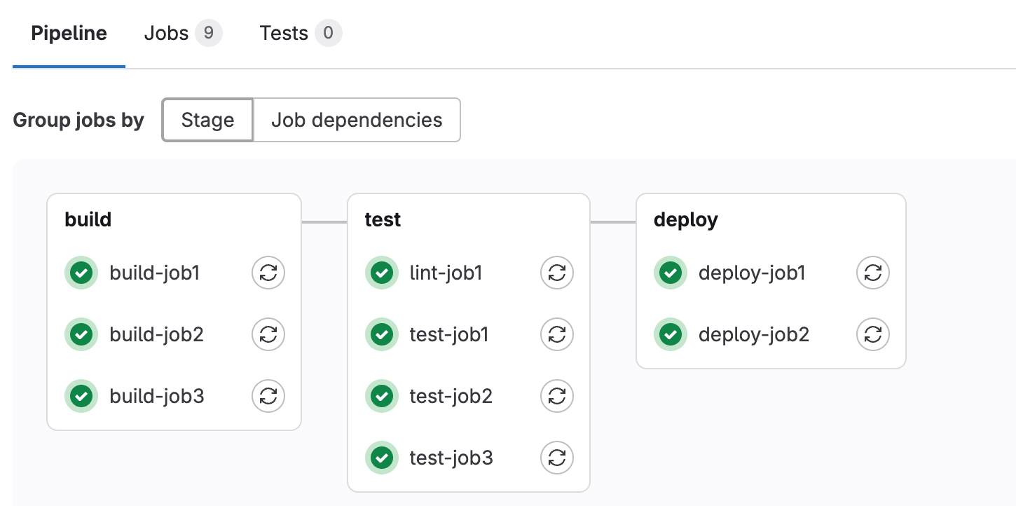

A typical pipeline might consist of four stages, executed in the following order:
- A
build
stage, with a job calledcompile
. - A
test
stage, with two jobs calledtest1
andtest2
. - A
staging
stage, with a job calleddeploy-to-stage
. - A
production
stage, with a job calleddeploy-to-prod

View full pipeline graph
Visualization improvements introduced in GitLab 13.11.
The pipeline details page displays the full pipeline graph of all the jobs in the pipeline.
You can group the jobs by:
Stage, which arranges jobs in the same stage together in the same column:
Job dependencies, which arranges jobs based on their
needs
dependencies.
