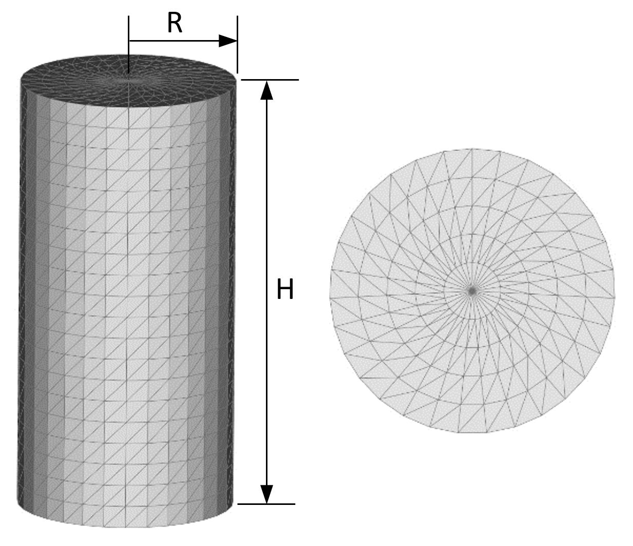

4.2.2.1. Cylinder
- Parameters:
Radius (R)
Height (H)
Number of divisions along the height
Starting angle in the circumferential direction
Ending angle in the circumferential direction
Number of divisions along the circumferential direction
Bottom cap
Number of divisions in the bottom cap’s radial direction
Top cap
Number of divisions in the top cap’s radial direction
The top and bottom caps are shaped like fans, i.e., they converge radially towards the center of the cap. Caps are not needed if the cylinder extends past the MFiX domain in the axial direction, when inlet/outlet boundary conditions are defined along the MFiX box (say at y=ymin and y=ymax for a vertical cylinder).
It is recommended to include caps when combining shapes (union, intersection, difference) since the boolean operations are more robust with closed shapes.

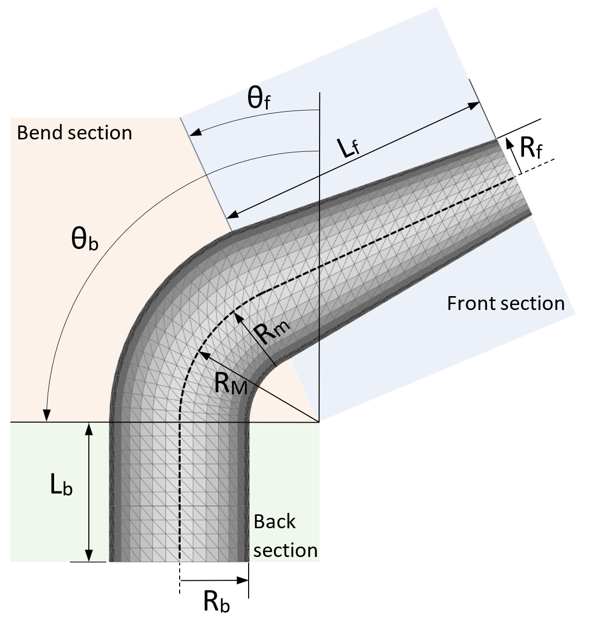

4.2.2.2. Bend
- Front section:
Length (L f)
Radius (R f)
Number of divisions along the front section length
- Back section:
Length (L b)
Radius (R b)
Number of divisions along the back section length
- Bend section:
Major radius (R M)
Minor radius (R m)
Starting angle (\({\theta}\) f)
Ending angle (\({\theta}\) b)
Number of divisions in the angular direction
- Circumference:
- Caps:
Bottom cap
Top cap

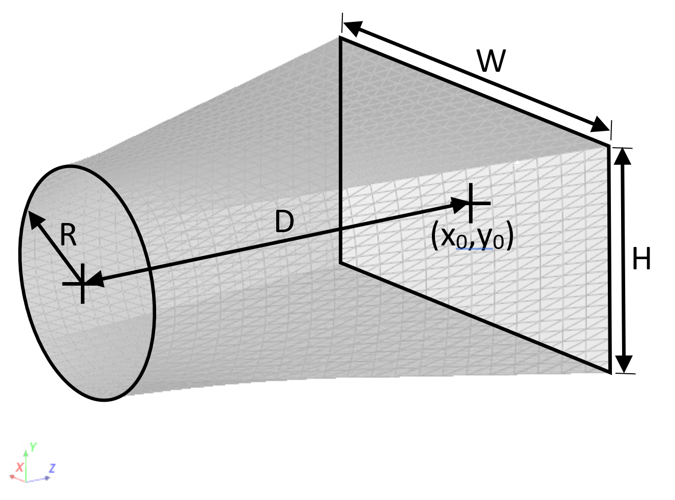

4.2.2.3. Cylinder to rectangle
Distance: distance between circle and rectangle in z-direction (D)
Resolution: number of divisions in the z-direction
- Circle section:
Radius (R)
Cap: option to fill the circle
Resolution: Number of divisions along the cap radial direction
- Rectangle section:
Width in x-direction (W)
Resolution: number of divisions along the rectangle’s width
Height in y-direction (H)
Resolution: number of divisions along the rectangle’s height
X Offset, Y Offset: location of the rectangle’s center (x0,y0)
Cap: option to fill the rectangle
Notes:
The cylinder’s center is located at (x=0,y=0,z=0).
The number of divisions along the circle’s circumference is the sum of the number of divisions of the rectangle’s width and height.

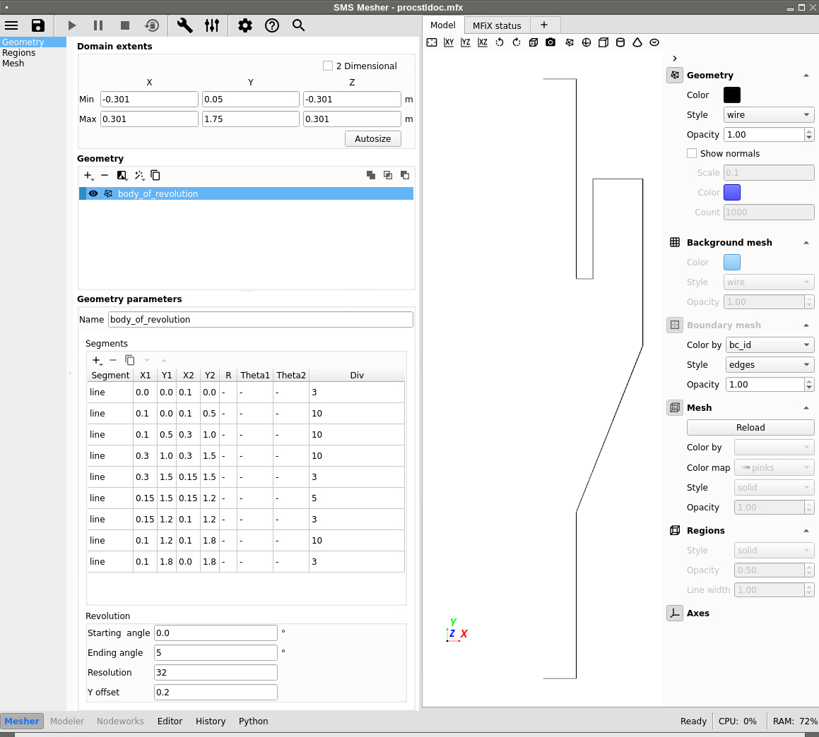

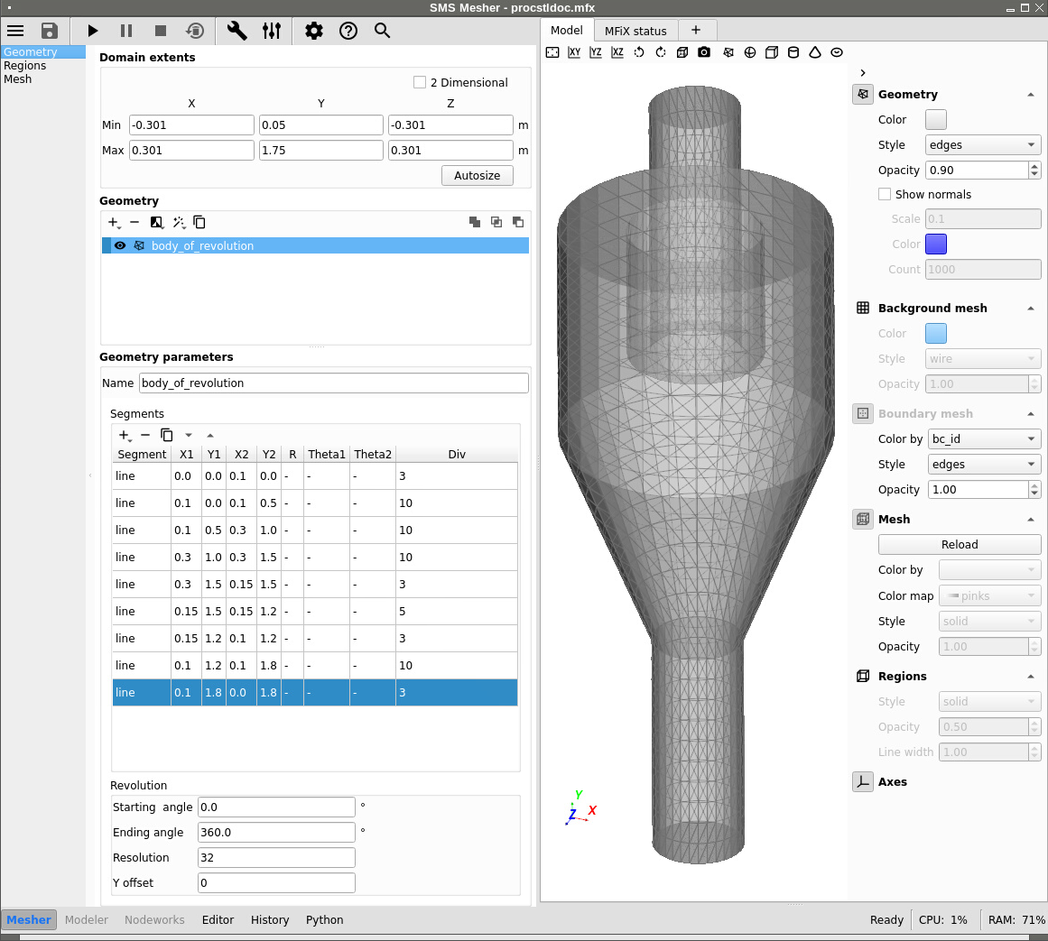

4.2.2.4. Body of revolution
The body of revolution shape revolves a profile (xy plane) around the z-axis.
A series of line or arc segments is defined in a table. Click the (plus sign) to add a segment and select either line or arc.
Segments:
- Line:
(X1, Y1): coordinates of the first point
(X2, Y2): coordinates of the second point
Div: Number of divisions along the segment
- Arc
(X1, Y1): coordinates of the arc’s center
R: radius
Theta1: starting angle (degrees)
Theta2: ending angle (degrees)
Revolution:
Starting angle (degrees)
Ending angle (degrees)
Resolution: Number of divisions along the circumferential direction
Offset: offset in y-direction (per revolution)
Notes:
See figure above for an example. The first and last segments are used to close the shape (bottom and top caps). Having a closed volume is preferred if the shape is used in boolean operation with another shape.
For complex shapes, it may be useful to align the view in the xy plane, set the ending angle to a small value (say 5 degrees) and set the style to wire with a black color. This allows to get a better view of the profile (see figure below). Once the profile is properly defined, set the ending angle to 360 degrees to generate the full 3D shape.
