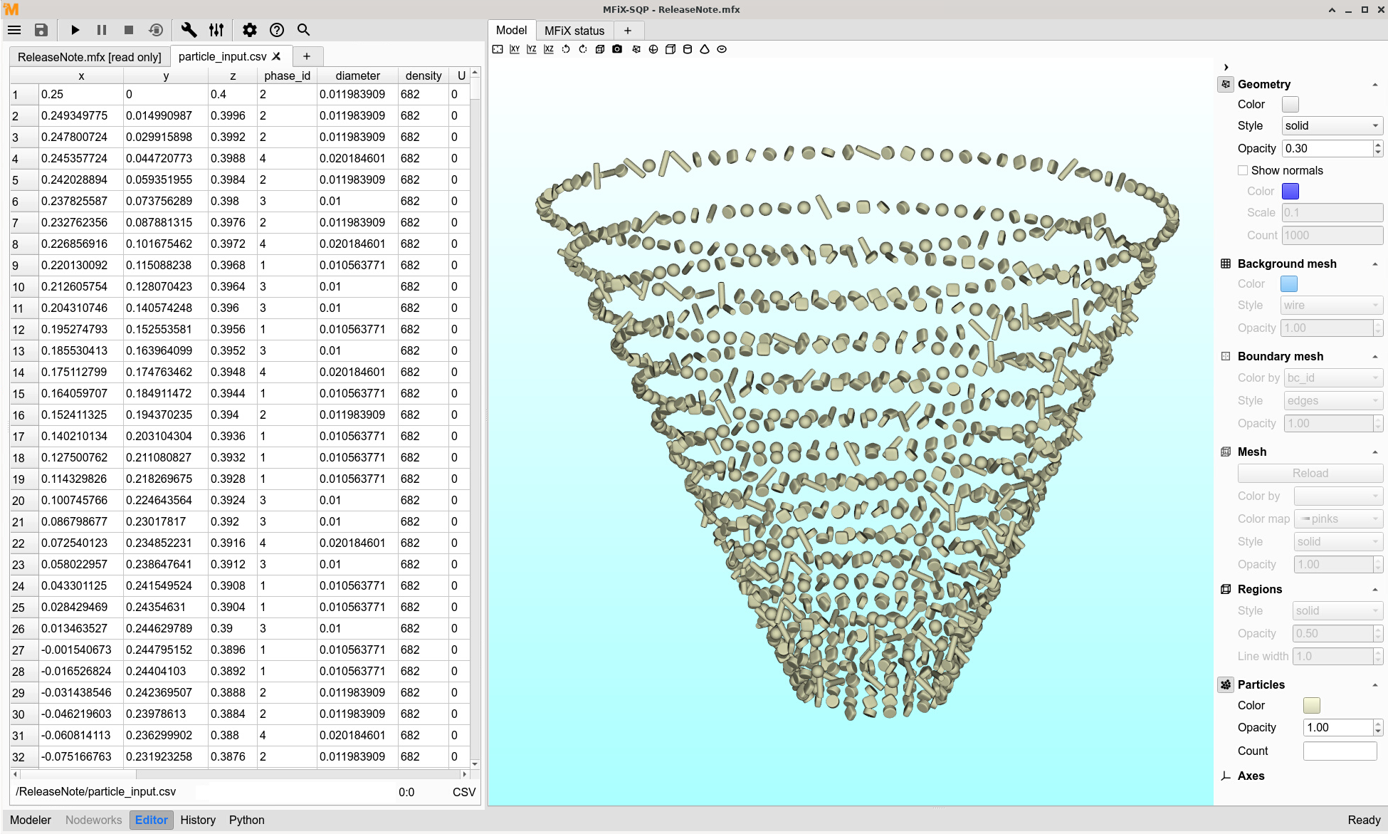

Enable automatic particle generation
Initialize particle location and velocity based on information from Initial Condition regions. If this option is disabled and any initial condition uses a non-zero solids volume fraction, the user will be prompted to turn on this option. Disabling this option will read initial particle location and velocity from a user generated text file (particle_input.csv) that must be saved in the project directory.

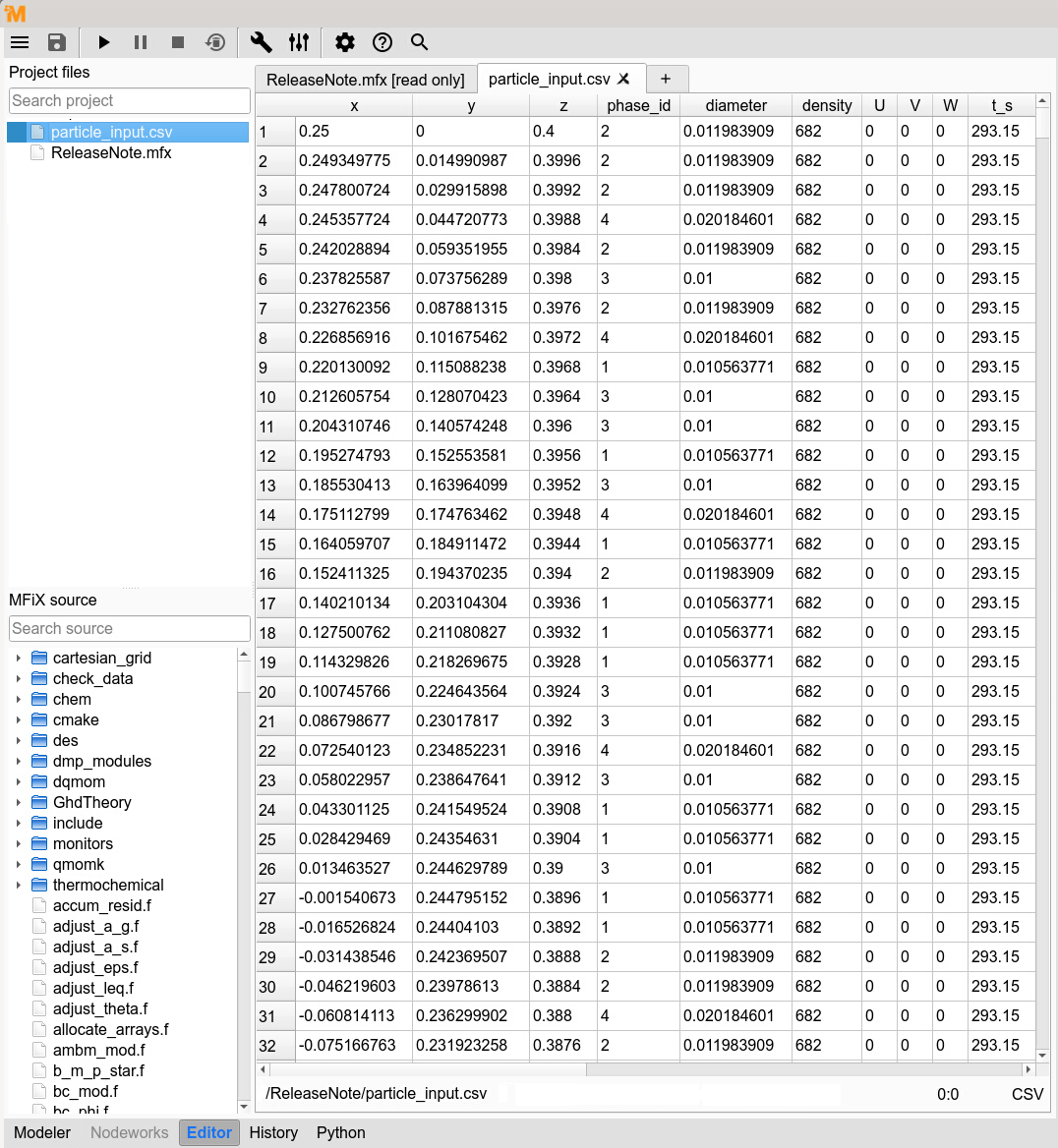

Data file particle count
The number of particles read from particle_input.csv file when the automatic particle generation is turned off. This number must be smaller or equal to the number of lines in the file.

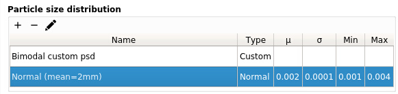

Particle Size Distribution (PSD)
A series of PSDs can be defined to be used in an initial condition region or a mass inlet boundary condition. A PSD represents the number of particles having a given size. It is currently a number-based (not volume-based) distribution. A new PSD is created by clicking the add button, Add, and entering the PSD parameters. The PSD can follow a Normal or Log-normal distribution. There is an option to load a text file containing a custom PSD.
PSD table
Figure 4.1 Particle Size Distribution table.
Initially, the table will be empty. Double click on one row to edit a PSD, Click on Remove to remove a PSD from the table.
First, enter a descriptive name for the PSD and choose the PSD type.
Parameters for the Normal and Log-normal distribution are:
  • Mean particle diameter
  • Standard deviation
  • Minimum diameter , used to clip the distribution and avoid extremely small particles
  • Maximum diameter , used to clip the distribution and avoid extremely large particles

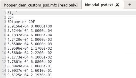

Custom PSDs will read the distribution from a text file. It can be edited through any text editor including the GUI built-in editor. The PSD custom file is organized as follows:
1st line: Number of points, number of distribution (this must be set to one currently).
2nd line: PDF (probability density function) of CDF (Cumulative distribution function).
3rd line: Header.
4th line and below: The data itself. First column is the diameter, second column is either the PDF or CDF value.
The figure below shows an example of a custom PSD file. Only the first few lines are shown.
PSD custom file
Figure 4.3 Example of a Custom file used to define a Particle Size Distribution.

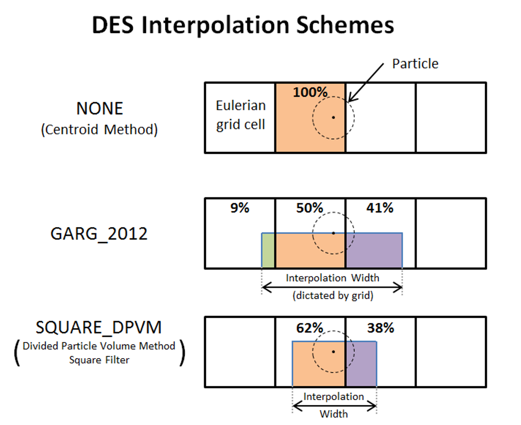

Interpolation
The direction of interpolation between field and particle data:
  • No interpolation
  • field-to-particle and particle-to-field
  • field-to-particle only
  • particle-to-field only
Scheme
The interpolation scheme:
  • None (centroid method)
  • Garg, 2012 (interpolation width is dictated by grid spacing)
  • Square DPVM (Divided Particle Volume Method), requires an interpolation width.
  • DPVM_satellite (SQP model only).
Width \((m)\)
The square DPVM interpolation width.
des interpolation scheme

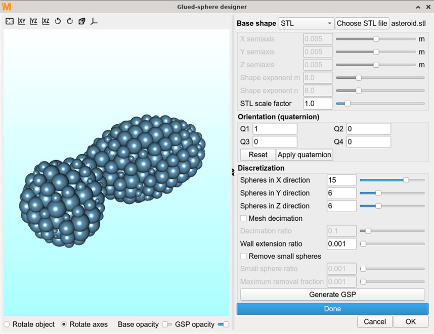

4.6.10.1. Glued-sphere designer
The configuration and generation of the glued-sphere particle is done through the Glued-sphere designer in the Materials tab. A pop-up window will open to define the configuration of GSP particles and save it as part of the input files.
GSP generator
Base shape
  • Superquadric: using the superquadric parameters to determine the shape of the particle. If using this option, then X-semiaxis,
Y-semiaxis, Z-semiaxis, shape exponent m and n should be defined.
  • STL: input the particle shape using the STL file, then STL scale factor allows the scaling of the input file.
Oritentation (quaternion)
The default orientation is aligned with the Cartesian coordinate system, and the particle centroid is located at (0,0,0). The initial particle orientation can be modified by specifying a quaternion before performing the actual discretization.
Discretization
  • Spheres in X direction
    Target number of component spheres in X direction.
  • Spheres in Y direction
    Target number of component spheres in Y direction.
  • Spheres in Z direction
    Target number of component spheres in Z direction.
  • Mesh decimation
    Enables the decimation of the input mesh, which increases the generation efficiency while losing some geometric features of the original shape.
  • Decimtion ratio
    A factor to determine the coarse level of the input mesh.
  • Wall extend ratio
    A factor to increase the size of the bounding box of the original shape.
  • Mesh resolution
    A fator to determine the mesh generated from the Superquadric parameters.
  • Remove small spheres
    An option to remove tiny component spheres after the generation of the GSP configuration, in order to improve solid time step determination.
  • Small sphere ratio
    If the ratio of the volume of a component sphere to that of the largest component sphere is smaller than this value, the component sphere will be removed from the GSP.
  • Maximum removal fraction
    Specifies the maximum fraction of particle volume that can be removed when eliminating tiny component spheres. The removal process stops once this limit is reached.
  • Generate GSP
    Click the bottom to generate the GSP configuration using the pre-defined setting. The generated component sphere will display in the window.

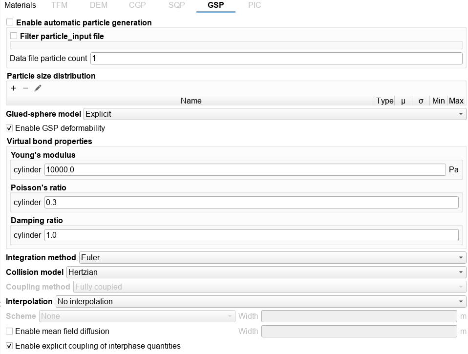

4.6.10.2. Glued-sphere model settings
GSP model setup
Specific GSP settings are accessed from the GSP tab.
Glued-sphere model
Select Explicit or Implicit for the representation of the GSP.
  • Explicit
    Dynamically track each component sphere during the simulation to achieve the intra-particle distribition (e.g. density, species and temperature)
  • Implicit
    During the simulation, only the GSP centroid is tracked, and the component sphere locations are derived from it. All component spheres are assumed to have uniform density, species composition, and temperature.
Enable GSP deformability
If GSP explicit model is in-use, an option will show up to choose whether the GSP deformability is enabled.
Virtual bond properties
  • Young’s modulus: the value of the Young’s modulus to use in the virtual bond force calculation, this value equals to the Young’s modulus of the specific solid phase.
  • Poisson’s ratio: the value of the Poisson’s ratio for the bond force calculation.
  • Damping ratio: the ratio of the damping coefficient to the critical damping coefficient. The critical damping coefficient is automatically calculated by MFIX.
Integration method
For GSP, the integration method is default to Euler. But the actual integration method is switched automatically by MFIX based on the GSP model.
  • GSP explicit model with rigid particles: MFIX will use Velocity-Verlet instead.
  • GSP explicit model with flexible particles: MFIX will use the default Euler integration due to dissipative nature of the virtual bond algorithm.
  • GSP implicit model: MFIX will use Velocity-Verlet scheme designed specifically for implicit sphere representation.
Collision model
  • Linear Spring Dashpot (recommended)
  • Hertzian
Enable explicit coupling of interphase quantities
For GSP simulation, only explicit coupling is allowed.

4.6.11. Particle data files
A new and unified version of particle data files is employed in MFiX as of version 24.3. Instead of using plain text files, the new version utilizes the CSV (comma-separated values) format. It supports the discrete element model (DEM) and its variant models: Superquadric DEM (SQP), Glued-sphere DEM (GSP), and Coarse-grained DEM (CGP).
The main reason for switching from a plain text format to a CSV format is to provide greater convenience for the user to edit particle data files and set up their own simulations. Moreover, the unified version facilitates the management of particle data files.
Overview of particle_input.csv
To use the CSV file as input, go to the Solids pane and select the solids model tab (DEM, CGP, SQP, or GSP). Uncheck “Enable automatic particle generation” and enter a positive integer for the “Data file particle count”. This number must be smaller or equal to the number of particles in the CSV file.
A particle_input.csv file consists of a header line and values for each particle variable. The number of columns represents the number of particle variables, and the number of rows represents the number of particles (excluding the first header line). A template of particle_input.csv will be provided in this user manual.
Major components of the csv file
1. must have variables: the first 3 columns (2 columns in 2D) represent particle locations. The particle position information is required in this data file, and it must be in the first three columns, or the first two columns if it is 2D.
2. extra variables: the input files can also have phase IDs, diameters, densities, and velocities. When energy or species are solved, or when using user scalar variables, the input files can include temperatures, species compositions, or user scalar variables.
3. model specific variables: For DEM sub-solvers (SQP, GSP, CGP), the input file can also provide model-specific variables such as superquadric parameters (SQP), particle orientations (SQP and GSP), or statistical weights (CGP).
Format of header
The header names have specific restrictions, and the user is expected to follow the naming conventions provided in the template. Note that all header names are case-insensitive. A brief explanation of each header name can be found below:
  • X, Y, Z: particle locations
  • phase_id: phase ids, which phase the current particle belongs to.
  • diameter: particle diameters, for specific sub dem model, the definition is different and it will be explained in the template section.
  • density: particle densities.
  • U, V, W: particle velocities in X, Y, Z directions.
  • t_s: particle temperatures.
  • species1, species2, ...: species fractions, header names for species columns are formatted as “species” followed by a number, where the number represents the species count.
  • usr_var1, usr_var2, ...: user scalar variables, similar as species, header names for user scalar columns are formatted as “usr_var” followed by a number, where the number represents the user scalar variables count.
header names for model specific variables are listed below:
  • sqp_a, sqp_b, sqp_c, sqp_m, sqp_n, sqp_q1, sqp_q2, sqp_q3, sqp_q4: Superquadric particles semi-axis, roundness and particle orientations.
  • gsp_q1, gsp_q2, gsp_q3, gsp_q4: Glued-sphere particles orientations.
  • cgp_stat_wt: Coarse-grained particles statistical weight.
Format of values
Generally, the user can use float format for all values. If the user prefers scientific notation, for example, 10000.0 can be written as 1.0e+04, and 0.001 can be written as 1.0e-03. Although variables such as phase_id and cgp_stat_wt are integers, the format does not really matter in this file. Maintaining the correct format is highly recommended for clarity.
The user is required to provide the number of particles when automatic particle generation is turned off. This number must be less than or equal to the number of lines in the file (excluding the header line). Note: For the GSP model, this value represents the number of glued sphere particles (not the number of component spheres!).
Particle data output
In the MFiX as of version 24.3, all DEM models support saving particle data into a CSV file for future use.
For GSP, the diameter is actually the bounding diameter. Once the user generates a gsp configuration through MFIX GUI, the bounding diameter is automatically calculated for the user to use in this file. However, the user has the freedom to adjust the bounding diameter to adjust the particle size while maintaining the particle shape.

4.6.13. Particle data file editor
The particle input file must be created in or copied to the project directory. It can be edited from the GUI. Select the Editor Tab at the bottom and select particle_input.csv from the Project files listing. The file will open in a new editor tab, and will be displayed as a spreadsheet. Each line corresponds to a particle. Data can be modified by selecting a cell and entering the new value. Operations on an entire column (say to set a constant value to the entire column) can be performed by right-clicking on the column header. Please note that the column name, content and order are specific to a given model and settings (energy equation, species, and user-defined variables). See the description above and examples for more details.
particle input file editor
4.6.14. Particle data file viewer
The initial particle positions can be previewed before running the simulation. Select the Model pane in the viewport on the right, scroll down to the bottom and select DEM to toggle the visibility of the particles. Changes made to the particle input file are updated in the viewport when the file is saved.
particle input file viewer
