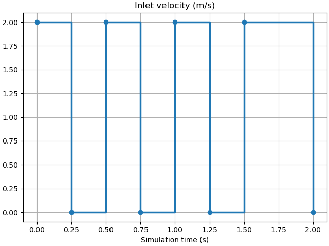

Below is an example of a keyframe data file used in the pulsating fluidized bed (tfm) tutorial. The gas inlet velocity is alternatively turned on/off.
"time (s)", "Inlet velocity (m/s)"
0.00, 2.00
0.25, 0.00
0.50, 2.00
0.75, 0.00
1.00, 2.00
1.25, 0.00
1.50, 2.00
2.00, 0.00
Figure 4.11 Plotting the pulsating inlet velocity keyframe data
