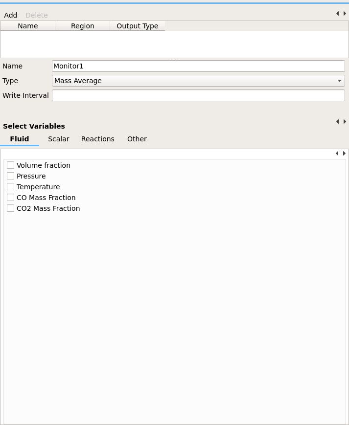

4.11. Monitors
A Monitor is a tool for capturing data from the solver about the model.
Data (such as volume fraction, pressure, velocity, etc.) for a given Region selection is written to a CSV file while the solver is running.
The number of monitors that can be defined for a project is limited to a maximum of 100.
../_images/monitors.png
Figure 4.10 Monitor pane
