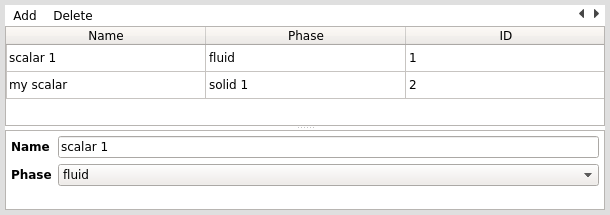

The MFiX GUI supports adding user-defined scalars.
This section defines how scalars are implemented into MFIX GUI. An example layout of the Scalar pane is shown below. The layout is similar to the Solids model pane: a table summarizes previously defined scalars and add/delete buttons allow scalars to be added and removed. Select a row of the table to edit the corresponding Scalar’s Name and Phase.
A table lists the user-defined scalar name, the convecting phase, and the scalar index.

To add a Scalar, navigate to the Scalars pane from the Modeler View, and click the (+) button.
To remove a Scalar, navigate to the Scalars pane from the Modeler View, select the scalar to remove, and click the (-) button.
4.7.2. Scalar Name: GUI-only description
By default, scalars are named “Scalar ID” where ID is the index of the scalar. It is recommended to edit the Name to something more descriptive. However, the scalar name is local to the GUI and not provided to the solver; in the solver and UDFs the Scalar is only referred to by Index.
