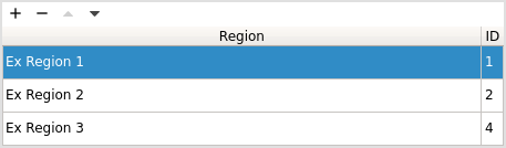

Initial conditions (ICs) are specified in the Initial conditions task pane. ICs summarized in the IC summary table illustrated in Figure 4.5. The MFiX solver will apply ICs in the order that they are defined in this pane. As a result, if two or more regions overlap, the IC with the larger index (ID) is used in the intersecting region. IC IDs are shown in the table, and can be changed using the up and down arrows.
Figure 4.5 Initial condition (IC) summary table.

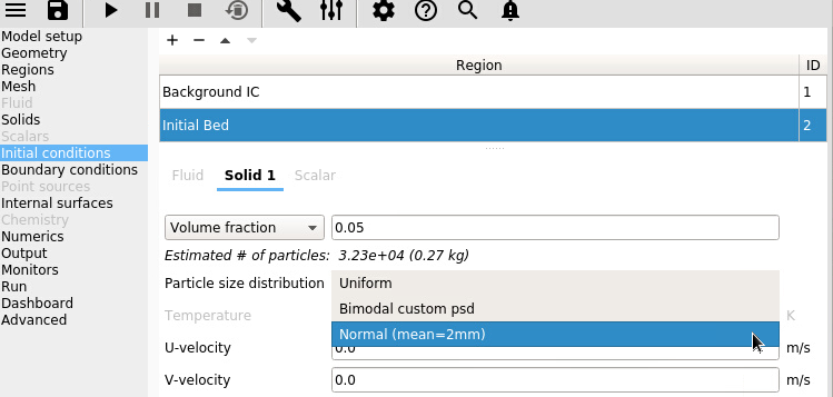

Particle size distribution (DEM solids only) Particle size distribution in the initial condition region. This can be left as “Uniform” (default) and the particle diameter (d_p0) defined in the Solids>Material pane will be used. If a PSD was defined in the Solids>DEM pane, it can be chosen here to initialize particles in this region with a PSD.
Figure 4.7 PSD used in initial condition region.

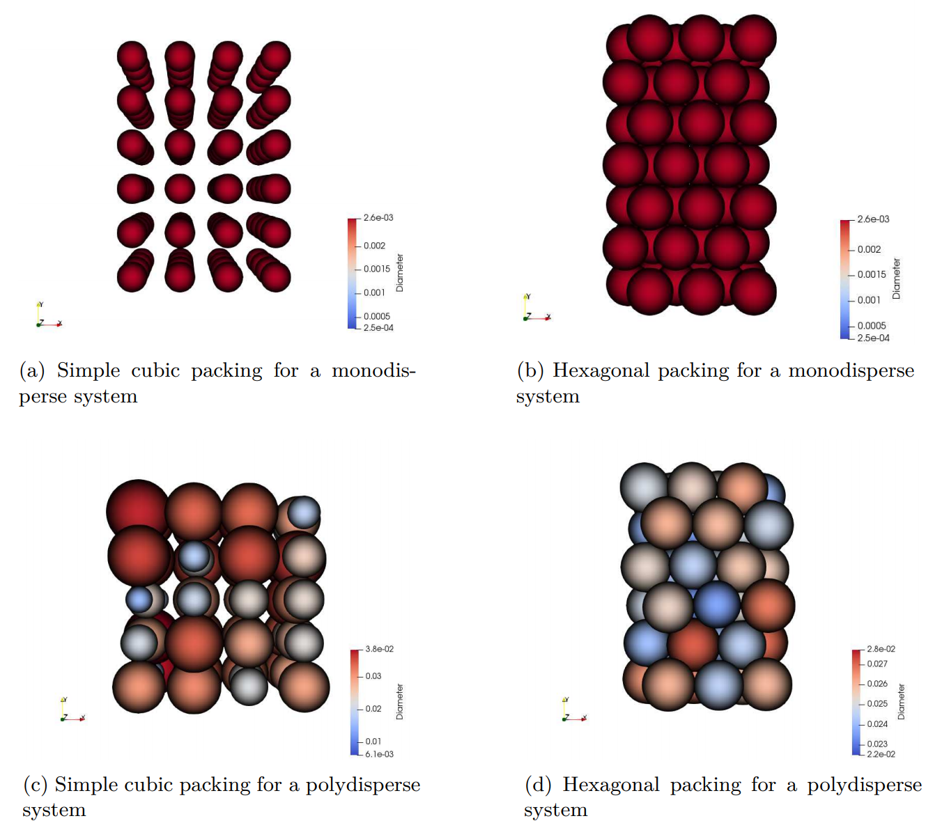

Initial lattice distribution (DEM solids only) Particles are initially seeding on a lattice, which can be cubic or hexagonal arrangement. Hexagonal arrangement can typically achieve higher packing density than cubic arrangement.
Figure 4.8 Examples of cubic and hexagonal lattice

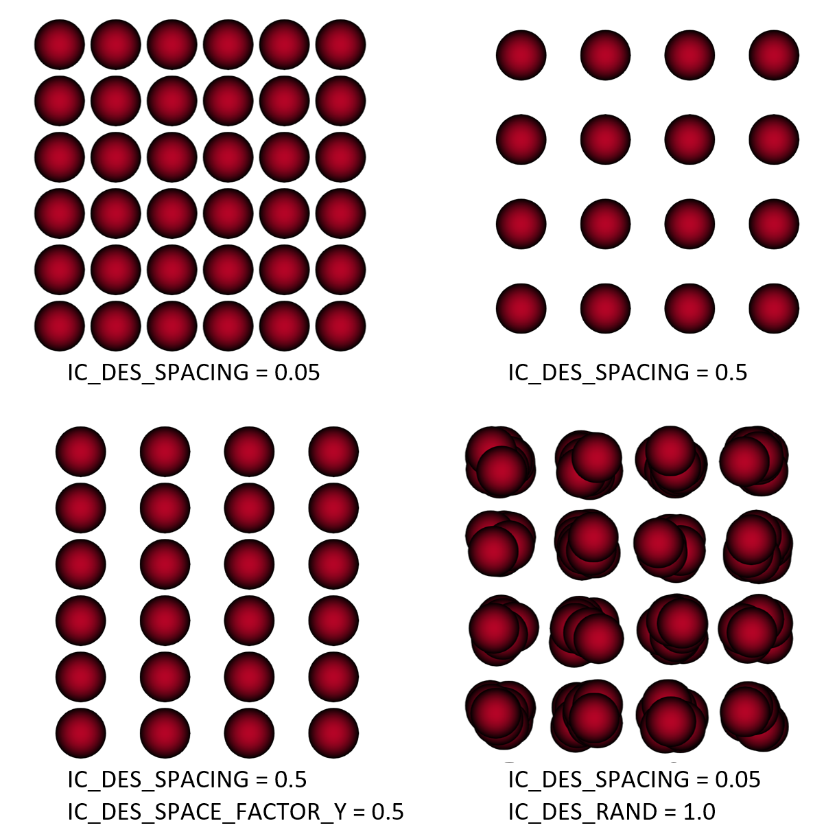

Spacing between particle (DEM solids only) Spacing (expressed as a fraction of the largest diameter, must be between zero and 1) between particles in the lattice. Default value is 0.05 (5% of the particle diameter). This spacing applies equally in all directions unless one of the spacing factors (x,y, or z direction) is less than one.
Spacing factor in x-direction (DEM solids only) Factor used to reduce the spacing in the x-direction (between zero and one). This factor is a multiplier to the overall spacing (if the spacing is 0.05 and the factor in x-direction is 0.5, then the effective spacing in the x-direction is 0.025 times the diameter).
Spacing factor in y-direction (DEM solids only) Factor used to reduce the spacing in the y-direction (between zero and one). This factor is a multiplier to the overall spacing (if the spacing is 0.05 and the factor in y-direction is 0.5, then the effective spacing in the x-direction is 0.025 times the diameter).
Spacing factor in z-direction (DEM solids only) Factor used to reduce the spacing in the z-direction (between zero and one). This factor is a multiplier to the overall spacing (if the spacing is 0.05 and the factor in z-direction is 0.5, then the effective spacing in the x-direction is 0.025 times the diameter).
Random factor applied to particle positions (DEM solids only) Factor to randomize the particle position around the baseline lattice position (between zero and one). The same factor applies in all directions unless a random factor less than one is specified in the x,y or z-direction.

Figure 4.9 Examples of spacing options with cubic lattice
