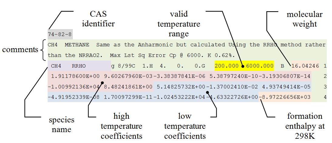

Example dataset from BURCAT.THR with notations:
Each entry in the database starts with a unique CAS identifier (74-82-8) for the species, followed by several lines of comments highlighted in green. The data section starts with the species name in columns 1-18 (CH4 RRHO). Common species names may be followed by strings (RRHO) that identify the method used to determine the coefficients. Additional information follows the species name. The numbers toward the end of the line are the temperature limits (200.000 6000.000) in degrees Kelvin where the property calculation is valid and the molecular weight (16.04246). Unlike CHEMKIN the common temperature for the high and low temperature branches are not recorded; it is always 1000 K. The next three lines give the fourteen coefficients (seven coefficients each for the high and low temperature branches) and the formation enthalpy at 298 K (which is also not included in CHEMKIN format). All the coefficients and the enthalpy of formation are normalized with the gas constant R (cal/mol/K). The low temperature coefficients (\(a_L\)) should be used for temperatures in the range Tlow to 1000K and the high temperature coefficients (\(a_H\)) should be used for temperatures in the range 1000K to Thigh. The coefficients are stored in a fixed format (E15.0) as follows:
\(a^1_H\) |
\(a^2_H\) |
\(a^3_H\) |
\(a^4_H\) |
\(a^5_H\) |
\(a^6_H\) |
\(a^7_H\) |
\(a^1_L\) |
\(a^2_L\) |
\(a^3_L\) |
\(a^4_L\) |
\(a^5_L\) |
\(a^6_L\) |
\(a^7_L\) |
\(\frac{\Delta H^{\circ}_f}{R}\) |
where \(\Delta H^{\circ}_f\) is the formation enthalpy at 298K.
