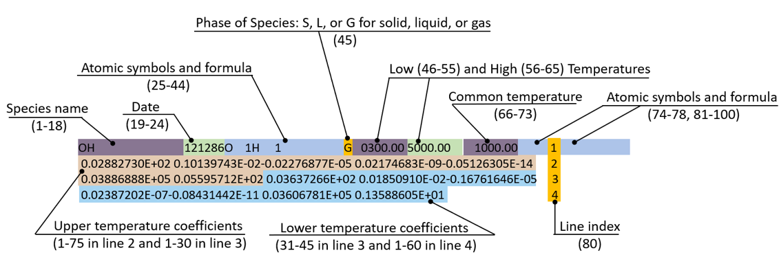

Example and explanation of thermodynamic database in CHEMKIN format
Figure 4.12 Example and explanation of thermodynamic database in CHEMKIN format.
  • Line 1: The main information includes the species name, the elemental compositions of the species, and the temperature ranges over which the polynomial fits the thermodynamic data are valid.
    • The species name is specified in the first 18 columns. If the species name is shorter than 18 characters, the rest of the characters should be filled with spaces.
    • Columns 19-24 are usually used to write a date, but they are not used further.
    • Columns 25-44 specify the elemental compositions of the species. Five characters are used for each element. The first two specify the element symbol, while the remaining three specify the number of atoms of that element in the species.
    • Column 45 specifies the species phase. S, L, or G can be used for solid, liquid, or gas phase.
    • Columns 46-55 and 56-65 specify the low and high temperatures over which the polynomial fits the thermodynamic data are valid.
    • Columns 66-73 specify the common temperature where the low-temperature polynomial fit switches to the high-temperature fit for thermodynamic properties. If it is blank, the default value, 1000K, will be used.

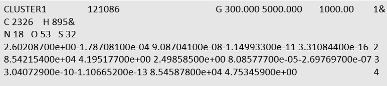

If the number of atoms of an element is more than 3 digits or the number of elements in the species is more than 4, an extended composition format needs to be used. In extended composition format, columns 74-78 and 81-100 are used for the elemental compositions of the species as well. Otherwise, columns 74-78 and 81-100 will be blank. Also, users can add an ampersand (&) after the index of the first line to indicate continuation to the next line, and the elements’ symbols and their amounts should be written on the next line. Any number of continuation lines may subsequently be included by adding an ampersand & at the end of a preceding line. The composition information used on these continuation lines is in free format, which consists of an element symbol, followed by the number of those atoms in the molecule, followed by another element symbol, and so forth. Figure 4.13 shows an example of the extended composition format.
../../_images/moreElement_species.png
Figure 4.13 Example of the thermodynamic database with extended composition format.

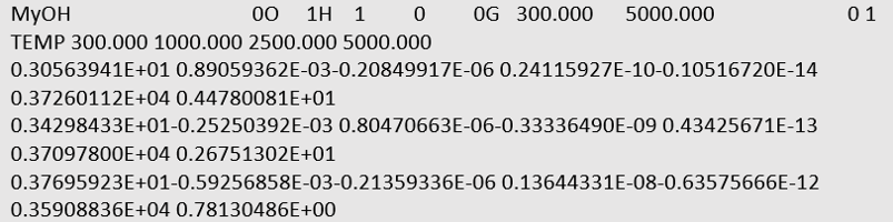

ANSYS CHEMKIN-Pro made some improvements to the temperature ranges in the thermodynamic information [1]. More than two temperature ranges can be defined by replacing lines 2-4 with a different format Figure 4.14 shows an example of a species (MyOH) with more than two temperature ranges. In this format, line 2 starts from TEMP in the first four columns followed by all the temperature values that define the temperature intervals. For each specified temperature interval, two lines are used to specify the required coefficients with 5 coefficients (\(a_1\) ~ \(a_5\)) in one line and 2 coefficients (\(a_6\) and \(a_7\)) in the other line. NOTE: The coefficients are given in descending order of temperature ranges.
../../_images/moreTemperature_species.png
Figure 4.14 Example of the thermodynamic database with more than two temperature ranges.

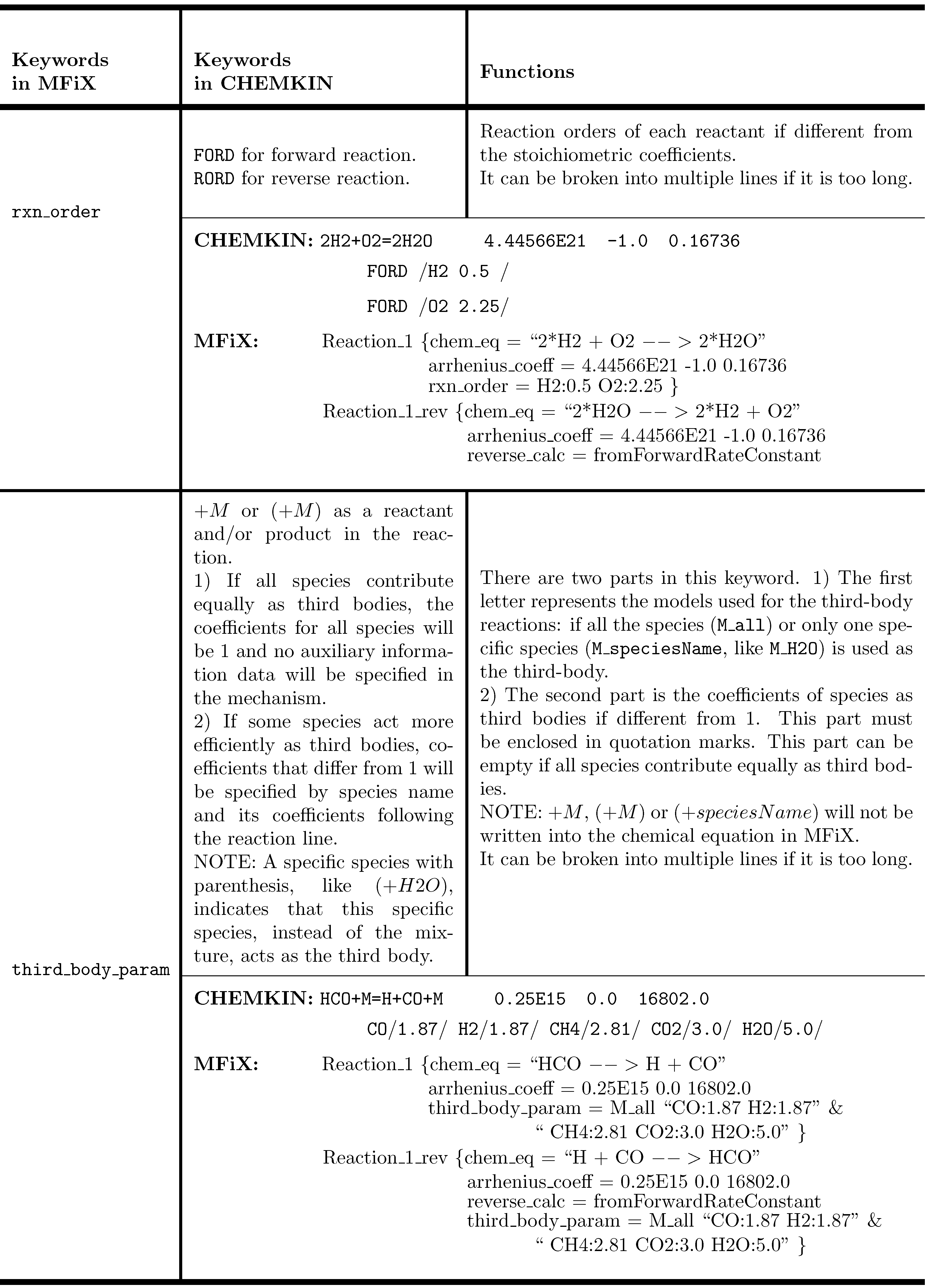

4.14.4.2.2.1. User-defined reaction orders
In some cases, the reaction rates may be proportional to the concentration of a species raised to some arbitrary power. in CHEMKIN, users can specify the reaction orders of species in the forward and reverse directions using the keywords FORD and RORD, respectively. In this way, the powers \(v'_{ki}\) in Eqn. (4.4) and \(v^"_{ki}\) in Eqn. (4.5) need to be replaced by the parameters following FORD and RORD. If the order of the species is not defined in FORD or RORD, the default value (its stoichiometric coefficients) will be used.
4.14.4.2.2.2. Third-body reactions
In some reactions, +M or (+M) is shown as a species in the reaction equation, which is called a third body. This is often the case in dissociation or recombination reactions. For the third-body reaction, the concentration of the effective third body must appear in the expression for the reaction rates as shown in the following equation.
(4.14)\[q_{f_i} = \left(\sum_{n=1}^N (\alpha_{ni})[X_n]\right) k_{f_i}\prod_{k=1}^K [X_k]^{v^{'}_{ki}}\]
(4.15)\[q_{r_i} = \left(\sum_{n=1}^N (\alpha_{ni})[X_n] \right) k_{r_i}\prod_{k=1}^K [X_k]^{v^{"}_{ki}}\]
(4.16)\[q_i = q_{f_i}-q_{r_i}\]
where \(N\) is the total number of species in the mixture. If all species in the mixture contribute equally as third bodies, \(\alpha_{ni}=1\) for all species and the first factor in Eqn. (4.14) and Eqn. (4.15) becomes the total concentration of the mixture.
(4.17)\[[M] = \sum_{n=1}^N [X_n]\]
In most cases, some species act more efficiently as third bodies than others, with \(\alpha_{ni}\) differing from 1. Its coefficients must be specified in the auxiliary data following its name.

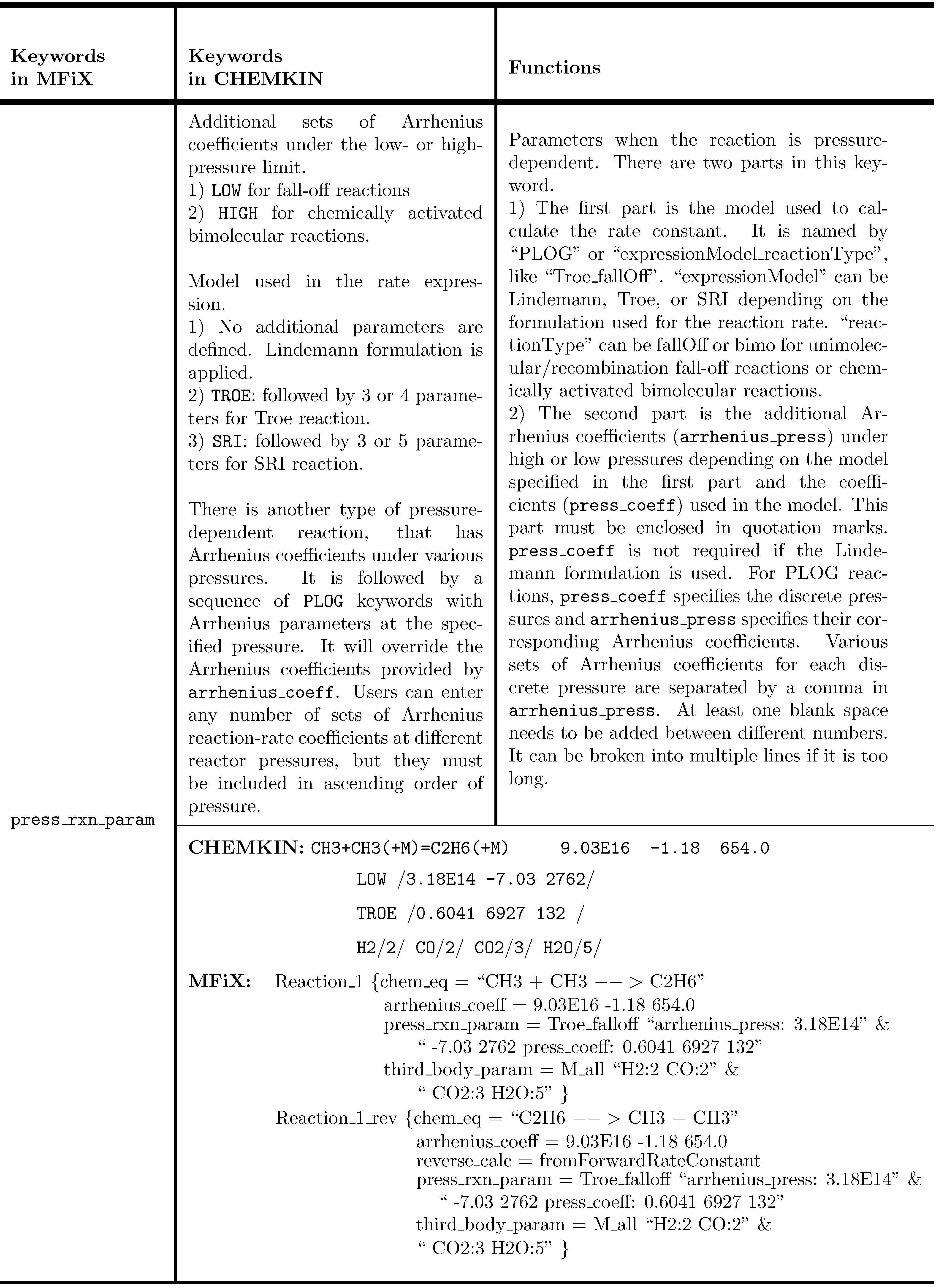

4.14.4.2.2.3. Pressure-dependent reactions
CHEMKIN also provides the reactions with reaction rates depending on both pressure and temperature. There are three main kinds of such reactions: unimolecular/recombination fall-off reactions, chemically activated bimolecular reactions, and reactions with general pressure dependence using logarithmic interpolation (PLOG reactions). With the increase of pressure, the rate of unimolecular/recombination fall-off reactions increases, while the rate of chemically activated bimolecular reactions decreases. For PLOG reactions, various pressures and their corresponding Arrhenius coefficients (\(A\), \(\beta\), and \(Ea\)) need to be specified. The rate constants for PLOG reactions are linearly interpolated with respect to the logarithm of the pressure in between two pressures.
Unimolecular/recombination fall-off reactions The rate constant at any pressure for unimolecular/recombination fall-off reactions can be expressed as
(4.18)\[ \begin{align}\begin{aligned}\begin{split}k = k_\infty \left(\frac{Pr}{1+Pr}\right)F \\\end{split}\\Pr = \frac{k_0[M]}{k_\infty}\end{aligned}\end{align} \]
where \(Pr\) is the reduced pressure. [M] is the third-body coefficient shown in Eqn. (4.17). In some cases, the third body can be a specific species instead of the mixture. In this way, the name of the species rather than (+M) will be added to the equation, for example, CH_3+CH_3(+N_2)<=>C_2H_6(+N_2), and the concentration of the species (\(N_2\) in this case) will replace [M] in the equation.
\(k_0\) and \(k_\infty\) are the rate constants for low-pressure and high-pressure limits, respectively.
(4.19)\[k_0 = A_0 T^{\beta_0} \exp(-Ea_0/R_cT)\]
(4.20)\[k_\infty = A_\infty T^{\beta_\infty} \exp(-Ea_\infty/R_cT)\]
There are three different methods to calculate \(F\) in Eqn. (4.18).
Lindemann form \(F=1\)
Troe form
\[ \begin{align}\begin{aligned}\begin{split}\log{F} = \left[1+\left[\frac{\log{Pr}+c}{n-d(\log{Pr}+c)}\right]^2\right]^{-1}\log{F_\text{cent}}, \\\end{split}\\\begin{split}c = -0.4-0.67\log F_\text{cent}, \\\end{split}\\\begin{split}n = 0.75-1.27\log F_\text{cent}, \\\end{split}\\\begin{split}d = 0.14, \\\end{split}\\F_\text{cent} = (1-\alpha)\exp(-T/T^{***})+\alpha\exp(-T/T^{*})+\exp(-T^{**}/T).\end{aligned}\end{align} \]
Here, \(\alpha\), \(T^{***}\), \(T^*\), and \(T^{**}\) need to be specified in the auxiliary information by keyword TROE. It must be noted that \(T^{**}\) may not be used in most cases. Therefore, 3 or 4 parameters are allowed to be defined in TROE.
SRI approach
\[ \begin{align}\begin{aligned}\begin{split}F = d\left[a\exp(-b/T)+\exp(-T/c)\right]^X T^e, \\\end{split}\\X = \frac{1}{1+\log^2 Pr}\end{aligned}\end{align} \]
Here a, b and c must be specified in the auxiliary information by keyword SRI. CHEMKIN adds parameters d and e to increase flexibility with default values of 1 and 0. Therefore, 3 or 5 parameters are allowed to be defined in SRI.
Chemically activated bimolecular reactions The rate constant at any pressure for chemically activated bimolecular reactions can be expressed as
\[k = k_\infty \left(\frac{1}{1+Pr}\right)F\]
The three methods to calculate F for unimolecular/recombination fall-off reactions, including Lindemann, Troe, and SRI, can be used here as well.

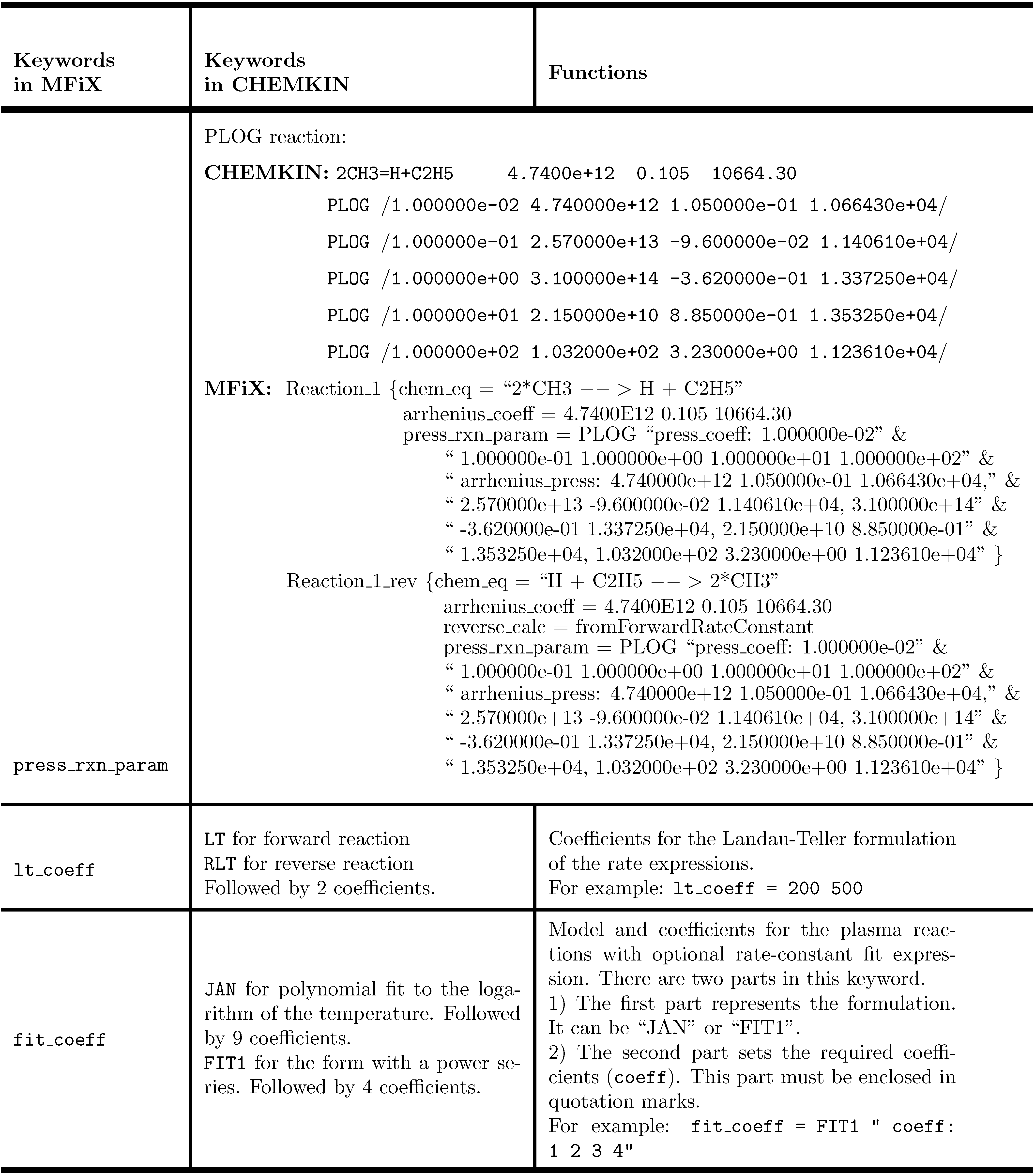

Reactions with general pressure dependence using logarithmic interpolation (PLOG reactions) For PLOG reactions, various Arrhenius parameters (\(A_m\), \(\beta_m\), and \(Ea_m\)) are required for discrete pressure within the pressure range of interest. For the specified pressure, \(P_m\), the rate constant can be expressed based on Arrhenius expression as follows.
\[k_m = A_m T^{\beta_m} \exp(-Ea_m/R_cT)\]
Users need to specify at least two different sets of parameters for two different pressures (\(m \geq 2\)). In some cases, more than one set may be provided for a given pressure, and then the sum of the sets of rate constants will be used for the given pressure.
If the pressure is lower than any of the pressures provided, the rate parameters provided for the lowest pressure are used. Likewise, if the pressure is higher than any of those provided, the rate parameters provided for the highest pressure are used. When the pressure P falls between the the two pressures (\(P_m\) and \(P_{m+1}\)), the rate constant (k) will be determined through logarithmic interpolation of the specified rate constants (\(k_m\) and \(k_{m+1}\)).
\[\ln(k) = \ln(k_m) + \frac{\ln(P)-\ln(P_m)}{\ln(P_{m+1})-\ln(P_m)}\left(\ln(k_{m+1})-\ln(k_m)\right)\]

4.14.4.2.2.5. Other constant fitting options
CHEMKIN provides two new rate-expression forms for plasma reactions.
Polynomial fit to the logarithm of the temperature
\[k_{f_i} = A_i T^{\beta_i}\exp\left(\frac{E_i}{T}+\sum_{n=1}^9 b_{ni}(\ln T)^{n-1}\right)\]
This form needs the definition of 9 additional parameters in the auxiliary data following the keyword JAN.
Power series within the exponential of a modified Arrhenius expression
\[k_{f_i} = A_i T^{\beta_i}\exp\sum_{n=1}^4\frac{b_{ni}}{T^n}\]
This form needs the definition of 4 additional parameters in the auxiliary data following the keyword FIT1.

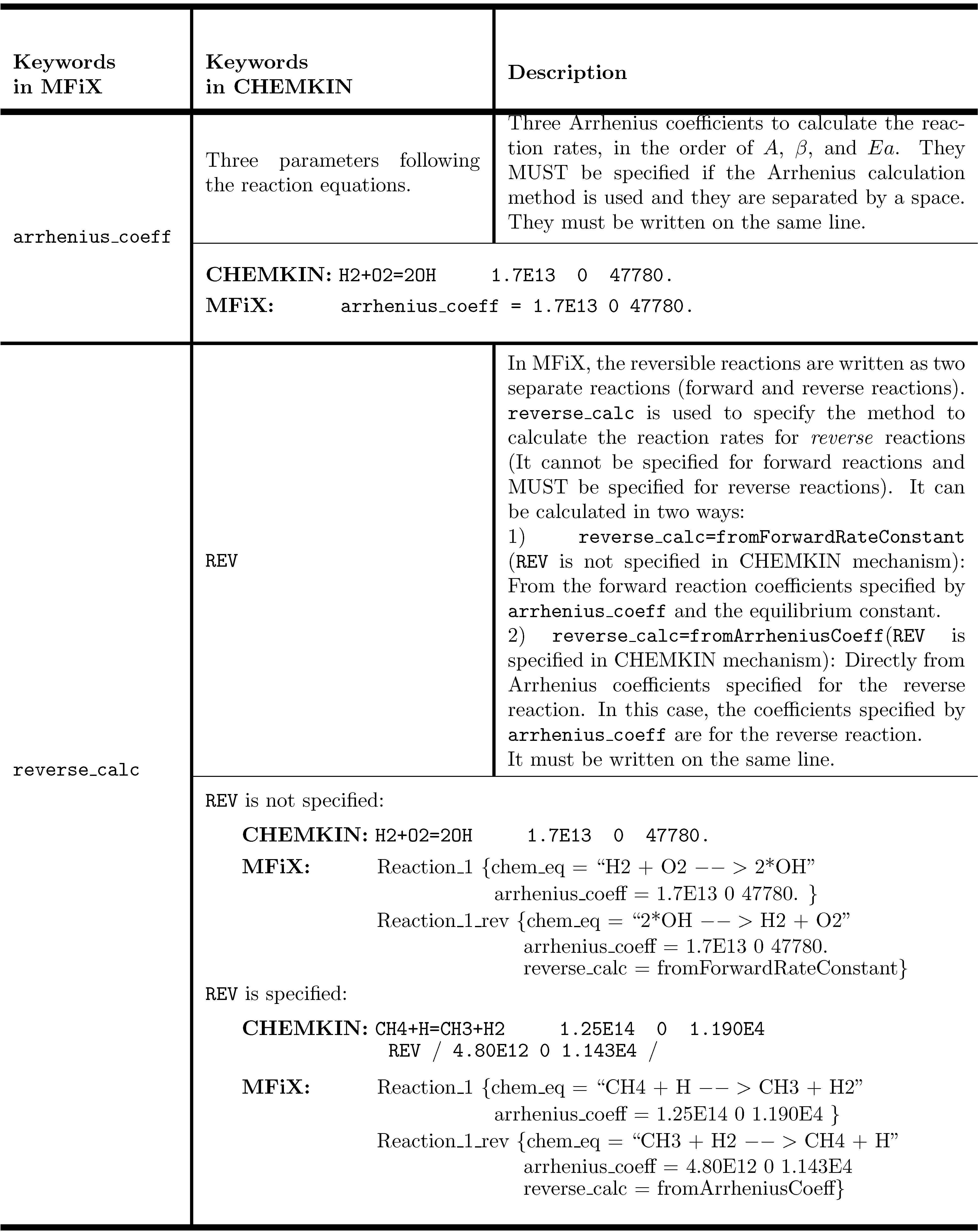

Figure 4.15 summarizes the required keywords and format used in MFiX for various types of reactions used in the CHEMKIN mechanism. Each keyword is required to be written in separate lines. For keywords, rxn_order, third_body_param and press_rxn_param, the line can be broken into multiple lines if it is too long by adding & at the end of the lines. All other keywords must be written in a single line.

The CHEMKIN mechanism defines a reversible reaction with = or <=> between reactants and products, and defines an irreversible reaction with => between reactants and products. MFiX always uses --> between reactants and products. Therefore, reversible reactions are written as two separate reactions, whose reaction rates are calculated independently (See Section Reversible reactions for more details). The reactions are written based on the sequence they appear in the mechanism using Reaction_index.
4.14.4.3.2.3. Arrhenius coefficients
Following the reaction equations in the CHEMKIN mechanism, the Arrhenius rate coefficients \(A\), \(\beta\), and \(Ea\) used in Eqn. (4.19), in that order, are specified. They will be added to the keyword arrhenius_coeff in MFiX with
arrhenius_coeff = \(A\) \(\beta\) \(Ea\)
The three numbers must be separated by at least one blank space.
4.14.4.3.2.4. Reversible reactions
In MFiX, the forward and reverse reactions in a reversible reaction are written as two different reactions. The parameters required to calculate the reaction rates, including the Arrhenius coefficients and the auxiliary information, are written twice under forward and reverse reactions. For example, a reversible reaction from CHEMKIN A+B=C or A+B<=>C will be written as
Reaction_1{chem_eq = A + B –> C}
Reaction_1_rev{chem_eq = C –> A + B}
There are two different ways to calculate the reaction rate of the reverse reactions. This is set by keyword reverse_calc for the reverse reactions in MFiX.
  • reverse_calc=fromForwardRateConstant: When keyword REV is not specified in the CHEMKIN mechanism, the rate constant of the reverse reaction will be calculated based on the forward reaction coefficients specified by arrhenius_coeff and the equilibrium constant using Eqn. (4.9).
  • reverse_calc=fromArrheniusCoeff: When keyword REV is specified in the CHEMKIN mechanism, the rate constant of the reverse reaction will be calculated directly from Arrhenius coefficients specified for the reverse reaction. In this case, the coefficients specified by arrhenius_coeff are for the reverse reaction.
4.14.4.3.2.5. User-defined reaction orders
The user-defined reaction orders specified by FORD and RORD in the CHEMKIN mechanism are written to the keyword rxn_order for forward and reverse reactions, respectively. For example,
rxn_order = A:0.5 B:2.0

4.14.4.3.2.6. Third-body reactions
In MFiX, the third-body species, +M and (+M), are not included in the chemical equations. Instead, they are indicated by keyword third_body_param. It includes two parts: the model defining which species are used as third body and the coefficients of third-body species.
  • If all species contribute as third bodies, M_all is used for the model.
  • If a specific species, like \(N_2\), is used as the third body, M_speciesName, like M_N2, is used for the model. Like +M and (+M), this species is not explicitly written in the chemical equation.
Following the model, the coefficients of the third-body species, differing from 1, are specified as a list of names and coefficients, separated by a colon. At least a blank space needs to be added between species. These coefficients need to be enclosed in quotation marks. For example,
third_body_param = M_all “A:1.0 B:2.0 C:0.5”
If the coefficients of the third-body species are not specified, a value of one will be used for the species. If all the coefficients of the third-body species are one, the second part enclosed in quotation marks can be omitted.
4.14.4.3.2.7. Pressure-dependent reactions
Additional sets of Arrhenius coefficients are required for pressure-dependent reactions. They are specified by different keywords in CHEMKIN based on the reaction type.
Unimolecular/recombination fall-off reactions The keyword LOW is required to set the Arrhenius coefficients for the low-pressure limit and the Arrhenius coefficients on the reaction line are for the high-pressure limit, which is written to keyword arrhenius_coeff in MFiX.
Chemically activated bimolecular reactions The keyword HIGH is required to set the Arrhenius coefficients for high-pressure limit and the Arrhenius coefficients on the reaction line are for low-pressure limit, which is written to keyword arrhenius_coeff in MFiX.
Reactions with general pressure dependence using logarithmic interpolation (PLOG reactions) Pressures and their corresponding Arrhenius coefficients need to be specified with the keyword PLOG.
For the first two types of reactions, there are three formulations for the reaction rate calculation, including Lindemann, Troe, and SRI. If Lindemann formulation is used, no additional keywords are required. For Troe reactions, the keyword TROE followed by 3 or 4 coefficients is required. For SRI reactions, the keyword SRI followed by 3 or 5 coefficients is required.
To set the pressure-related parameters in MFiX, keyword press_rxn_param is used. There are two parts for this keyword.
  • The first part is the model used to calculate the rate constant. It is named by PLOG or expressionModel_reactionType, like Troe_fallOff. expressionModel can be Lindemann, Troe, or SRI depending on the formulation used for the reaction rate. reactionType can be fallOff or bimo for unimolecular/recombination fall-off reactions or chemically activated bimolecular reactions.
  • The second part is the additional Arrhenius coefficients arrhenius_press under high or low pressures depending on the model specified in the first part and the coefficients press_coeff used in the model. This part must be enclosed in quotation marks. press_coeff is not required if the Lindemann formulation is used. For PLOG reactions, press_coeff specifies the discrete pressures and arrhenius_press specifies their corresponding Arrhenius coefficients. Various sets of Arrhenius coefficients for each discrete pressure are separated by a comma in arrhenius_press. At least one blank space needs to be added between different numbers.

4.14.4.3.2.10. Landau-Teller formulation and other constant fitting rate expressions
The two parameters in the keyword LT or RLT for the Landua-Teller formation in the CHEMKIN mechanism is written to the keyword lt_coeff in the MFiX input file. At least one blank space needs to be added between numbers, a and b.
lt_coeff = a b
The JAN or FIT1 constant fitting options are written to keyword fit_coeff in the MFiX input file. The model, either JAN or FIT1, needs to be specified as the first part of the keyword. The second part, enclosed in quotation marks, defines the required coefficients with coeff: following with the numbers. At least one blank space needs to be added between numbers. 9 and 4 coefficients are required for model JAN or FIT1, respectively.
fit_coeff = JAN “coeff: 1 2 3 4 5 6 7 8 9”

Figure 4.15 Keywords used to specify the parameters from the Arrhenius mechanism in the MFiX reaction block.
